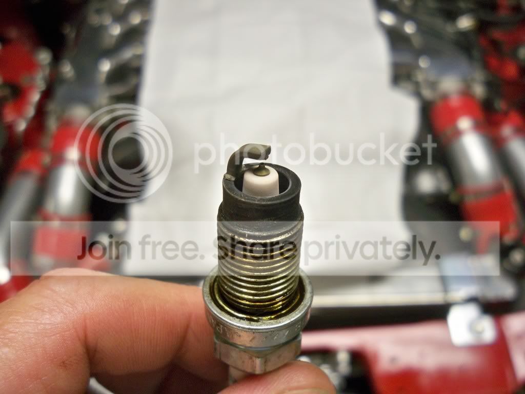

This is what the plugs looked like .
5 out of the 6 plugs looked like this one.

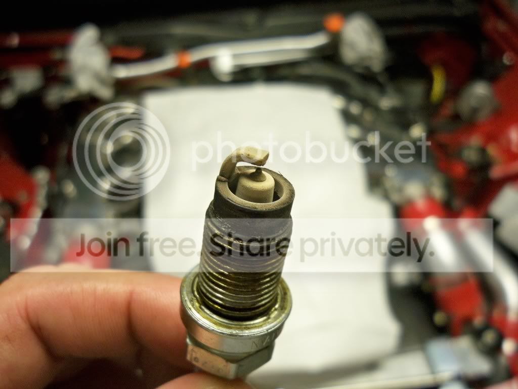

The plug in #3 looked like this .

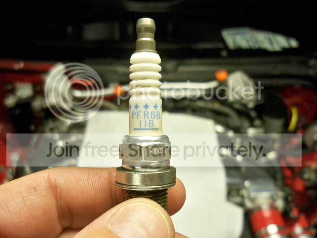

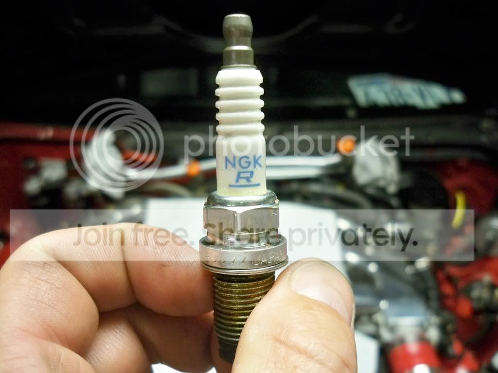

Plug type , gapped to .035
What's goin on with plug #3 ?
My AFR is exactally the same on both banks via 2 wideband .
